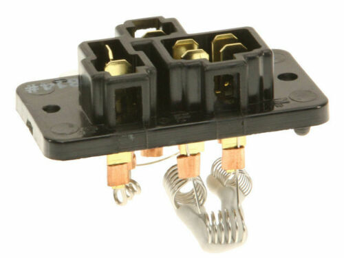

I been looking under the dash on the passenger's side and can't find anything resembling it. Any help would be appreciated.

Remove the glove box and plastic panel above your feet on the passenger side. It is located by the blower fan.

I know where it should be by the pictures you posted, but it isn't. Removing the kick plate and glove box, I can clear access to the blower motor but can't see anything with two bolts and connectors like the two pictures. Could it have been relocated elsewhere further from the blower motor?

All you will see is the wires plugged into this. The rest of it is inside.
