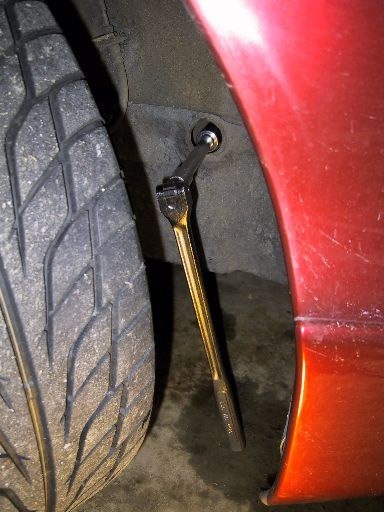

Before jacking the car up, MTX and ATX PGT’s should turn their wheel to the left and pop out the rubber plug in the splash well. The crank bolt is accessible directly inline with this hole pictured here………
Crank Bolt Access
Put the MTX in forth gear and set the parking brake firmly. The bolt can easily be broken loose with a breaker bar.
ATX trannys will have to brace the breaker bar against the frame rail and tap the starter to crank the engine and pop the bolt loose.

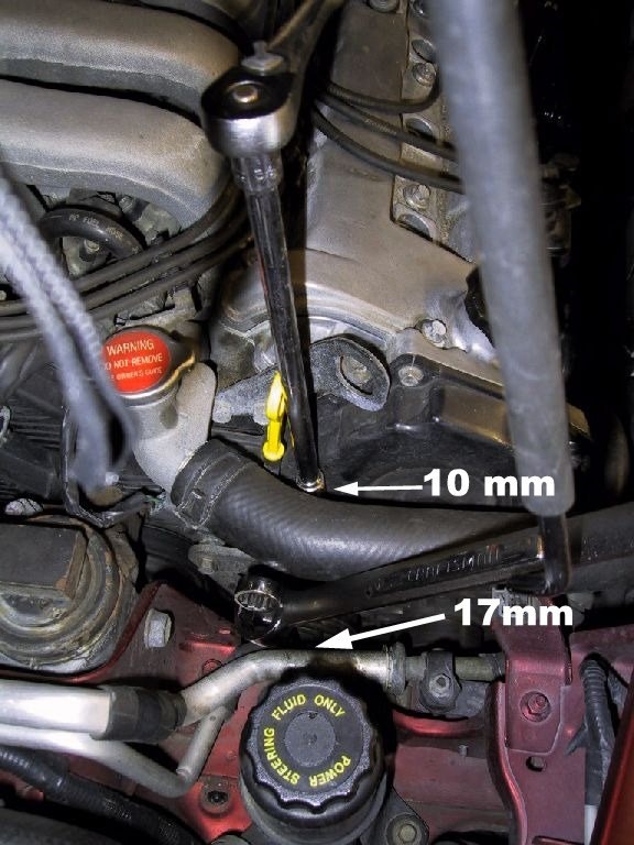

This belt is tensioned with a pulley that is forced down via long bolt and thread. You must unloosen the 17mm locknut on the pulley and then you can turn the 10mm adjustment bolt counterclockwise to raise the pulley wheel off the belt. Once the pulley is fully loose, remove the locknut as well as the pulley itself. By the way, the lock nut is somewhat difficult to access. I use a 1” combination wrench turned sideways over the end of the 17mm wrench for leverage. This can be pictured here…..
Upper Accessory Belt Adjuster

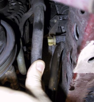

Behind the coolant cap on the passenger side is two coolant related sensors that pass over the belt area. There is also the Crankshaft Position Sensor connector right under the radiator hose. Disconnecting these is not required, but it certainly makes it easier. Push them out of the way once disconnected. The ford manual recommends removing the upper radiator hose, but this really isn’t necessary.

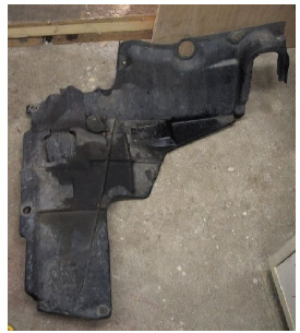

(Remove the lower splash)
The lower right engine splash shield must be removed. There are an assortment of bolts and snap clips used to hold it on. Remember to push the center of the plastic rivets in to unlock them before attempting to remove them. The center must be pushed out past the rivet surface to reset them for installation. My PGT had both 10mm and one 8mm bolt holding the shield on The shield and bolt holes can be seen here……
Splash Shield Removed

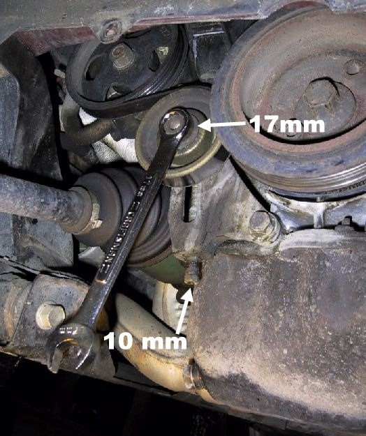

(Remove Power Steering Belt and adjuster)
Once the Splash Shield is removed, you will have easy access to the other belt adjuster. As before, crack the 17mm nut loose and turn the 10mm adjuster until the belt is loose. Remove the locknut and pulley completely. Remove the belts as well. This can be seen here……
Lower Accessory Belt Adjuster

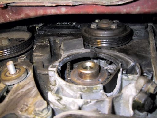

(Remove Crank Bolt and Pulley)

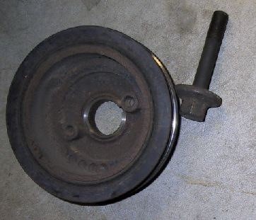

Now that the belts are removed and pressure is off the crank, remove the crank pulley bolt and wobble the balancer/pulley back and forth until it loosens up and slides off. In some cases, the pulley will need to be carefully pried off with tools. If necessary, place suitable pry bars behind each side of the pulley and force it off. Be careful not to damage other parts or the crank position sensor. Sometimes its helpful to smack the lip of the crank pulley a few times with a rubber or rawhide mallet to break it loose. The pulley is keyed to the crankshaft and gets rusted on. The parts can be seen here……
Crank Pulley

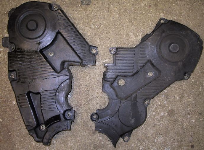

Next, remove the upper cover 10mm bolts. There are three around each cam sprocket (be prepared to fight for the bolt on the bottom rear edge of the rear cam ), one in the “V” of the block and another on the rear (left) cover in a similar place as the oil tube bolt on the right cover. Remove the covers. All these bolt locations can be seen here……
Timing Covers

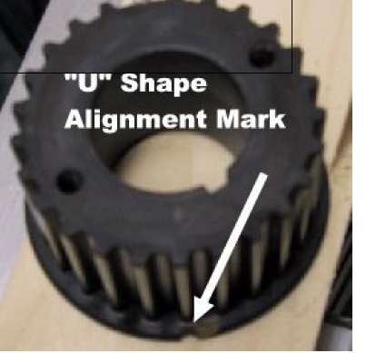

The crankshaft marks are a triangle shape at 12 o’clock on the engine block and a “U” shaped notch on the sprocket. Note this picture has the crank turned slightly as required for install. These can be seen here…..
Crank Alignment Marks
and here………….
Crank Sprocket Notch

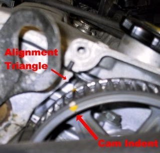

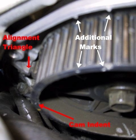

The cams are aligned by via a triangle shaped mark on the cylinder head and a circle punched into the cam sprocket that usually has colored paint on it.
Although the pictures are blurry ….sorry….but I’m not taking it apart again for more pictures …..you can see them here…..
Front Cam Alignment
Rear Cam Alignment

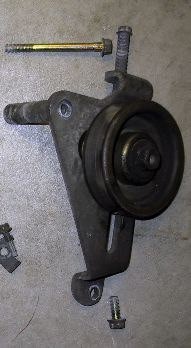

(Timing Belt Hydraulic Tensioner Arm Removal)

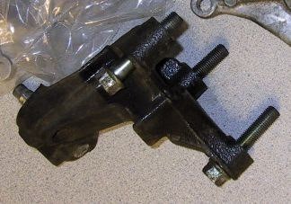

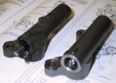

This is the infamous part that fails and allows a knocking noise to happen. There are two bolts that hold the tensioner arm in place. Take the bottom one out first. Once removed, THROW IT IN THE GARBAGE and replace it with a new one (try www.fordprobeparts.com). Although it is very expensive, it doesn’t make sense to reuse this if it has any substantial miles on it. If for some odd reason you are removing a newer part, compress the post back into the arm with a press of vice very slowly and straight. Hold the post in place in the LOWER of the two holes with a drill bit or larger sewing needle. It looks like this…….notice the grease and dirt on the old one for those of you that heard my MP3 of the knocking noise……..
Tensioner Arm
Remove the belt. If you are reinstalling the same belt, be sure to mark the direction it was installed. Never install a used belt backward. The fibers tear inside the belt.

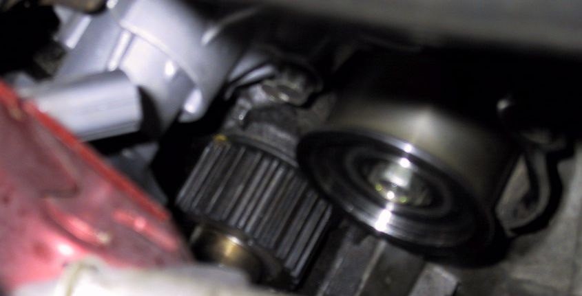

By the way, for those of you who want to know what makes that terrible knocking noise, it’s the tensioner pulley hitting the rear metal timing belt cover seen here…….
The Pulley Noise !!!!

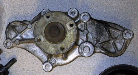

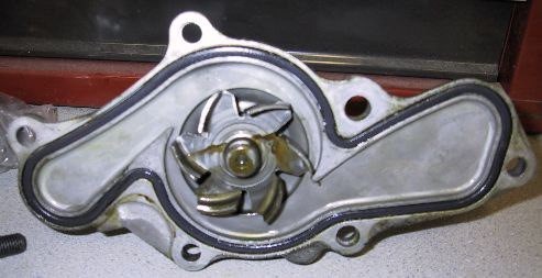

Remove the 5 remaining pump bolts and remove the pump. Make sure all the rubber “O” ring seal came off with the pump. Both parts look like this………..
Water Pump
Pump Gasket

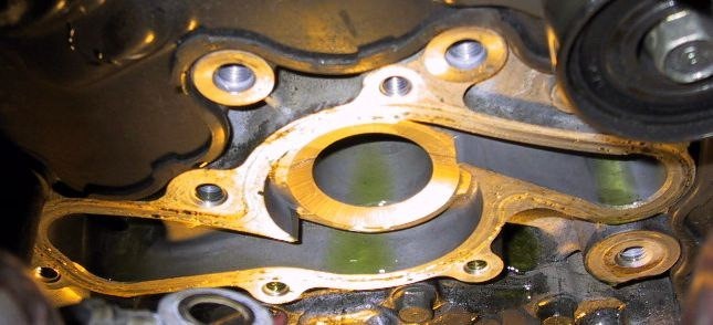

(Clean Mounting Surface)
Clean the pump mounting surface on the engine to remove corrosion which looks like this…..
Water Pump Mounting Surface

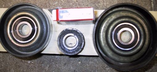

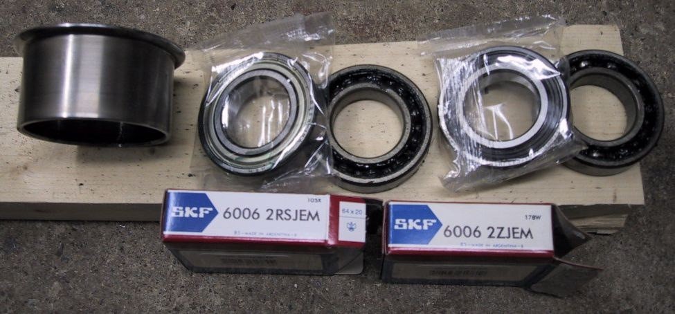

If you’re like me and love a quiet smooth engine, you’d probably like to replace bearings when at all possible if they were cheap, right? Well here you go. I replaced all the bearings in the timing belt idlers and the car sounds fantastic just like new with 138K on it.
(The facts)
Each idler has 4 parts to it……a core piece, TWO bearings and the outer shell. The idlers are in the $160 dollar range each from Ford or Mazda. The bearing themselves have the number NSK 6006DWA on them. The 6006 bearing is very common, but not the DWA distinction. In fact, no one (even NSK reps) had ever seen a DWA on a bearing. I finally got a guy to call NSK Japan office. They found it was a special seal design for automotive use with 40% less seal drag, and of course you can’t buy them.
So what now? Here is my solution that works well. The factory idlers have two bearings pressed face to face with the inner seals removed (less drag I would imagine). I decided to use a standard 6006 on the outside bearing and a “no contact” type 6006 on the rear. My theory is the rear of the idlers were very clean and not easily covered with dust……..and 100% seal drag + 0% seal drag puts me 10% better than OEM. I pried off the inner seals like the factory did before pressing them back in. Each standard 6006 was $16 and the “no contact” 6006 was $12
They look like this……..
Timing Idler Bearing Replacement
One Idler Reinstalled
(Bearing replacement)
You have to be creative here if you don’t own a press. I used a variety of wood blocks and sockets to drive out the core and then the bearings. I braced the flanged part of the shell on four pieces of plywood while pounding out the bearings. Use a wood block and sledge to drive the bearings back in by the outside shell (to protect them). Make sure to pry off the inner seals before installing them. Lube the surface of the bearing with something light like liquid wrench to make pushing them in easier. This is really the best money ever spent on my car.

(Install Tensioner Arm)
Tighten bolts to 14-18 LB-FT and remove the pin holding the pushrod. Check timing belt tensioner pulley bolt for 28-32 LB-FT
