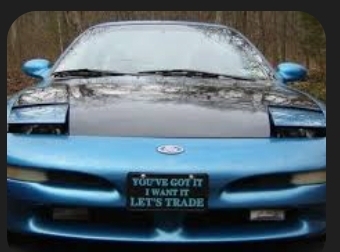

Post by 1stgenWizard » Mon Mar 04, 2024 8:27 pm
Easy and cheap to do.
1. Find retra fuse in your fuse box under the hood.
2. Get some male connectors that look like the fuse connector terminals, crimp them onto a wire and heatshrink.
3. Attach wires to momentary button, run all the wires, test it out, your done.
