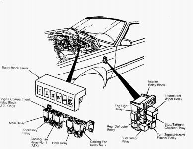

89-92 Main relay box on firewall and interior relay block layout
Post by 1stgenWizard » Fri Aug 07, 2020 12:52 am
In the following order; Passenger Side to Driver Side
Horn Relay 4 Socket Plug
GN/R
GN/W
GN/W
GN/O
Cooling Fan Relay 6 Socket Plug
BK
BK/Y
BK/GN
BK/Y
EFI Relay No.1 4 Socket Plug
W/GN
R/BK
BK/W
BK
EFI Relay No.2 4 Socket Plug
W/R
BR
BK
BK/W
KEY
BK=BLACK
W=WHITE
R=RED
GN=GREEN
BR=BROWN
Y=YELLOW
O=ORANGE
/=STRIPE Color after the "/" is the striped color.
