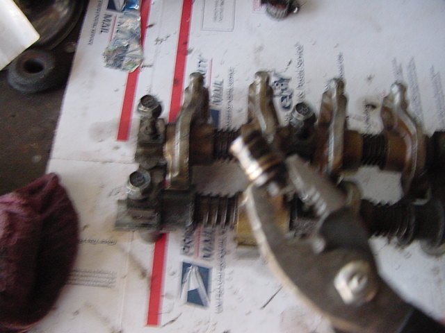

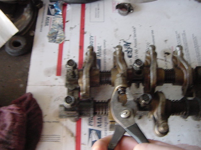

6.)Use pliers to remove the HLA as shown in the picture. When you are inspected each HLA, you should be looking for collapsed HLA's and also a really loud tapper can be a burnt HLA, these are like frozen and will not adjust anymore, you can check for these by doing a compress test with each HLA, by putting them in some clean oil and try compressing them your fingers or pliers carefully, They should compress and squirt out oil out one end, if it doesn't compress and its hard as a rock toss it and get a replacement.

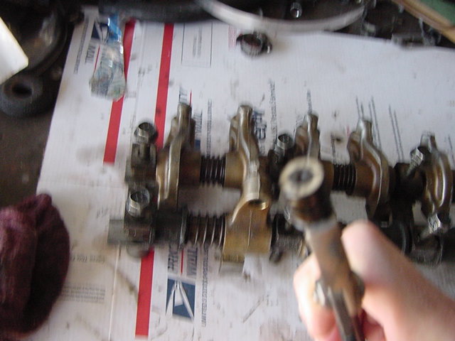

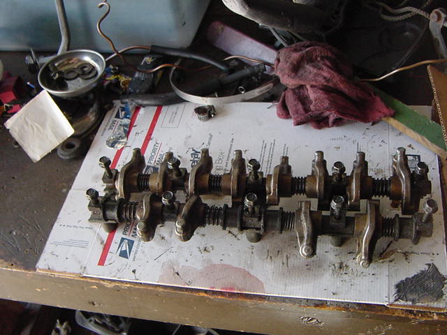

Rocker Arm assembly removed from cylinder head

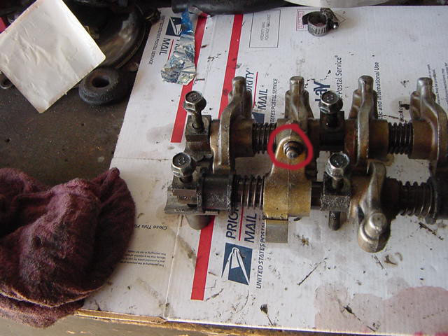

HLA Location
Using pliers to remove HLA, I did this with one hand, so their easy to get out
